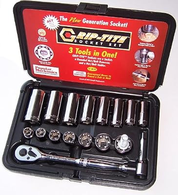

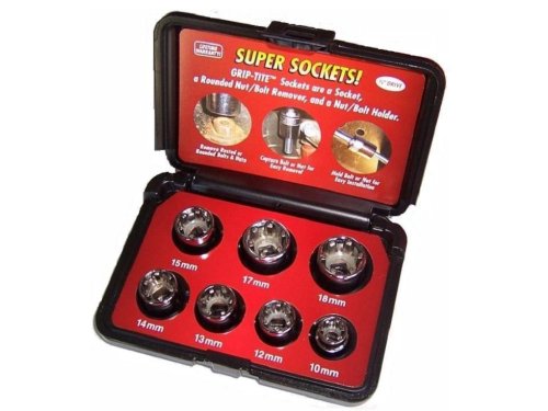

You need a GRIP-TITE socket set, I believe you can get them from Sears or Amazon. You can use a shallow socket for a spark plug, but you have to break off all the porcelain so that a shallow socket can get to it.
Here is a deep socket set
You could also break off all the porcelain well into the head and use an easyout, but you would risk getting debris inside the combustion chamber. Do the lubricate, heat etc. while using the Grip-tite socket.
This set by Erwin might do as well but it doesn’t go to 13/16", but the 3/4" might work. If you have 5/8" plugs, then you are set.
