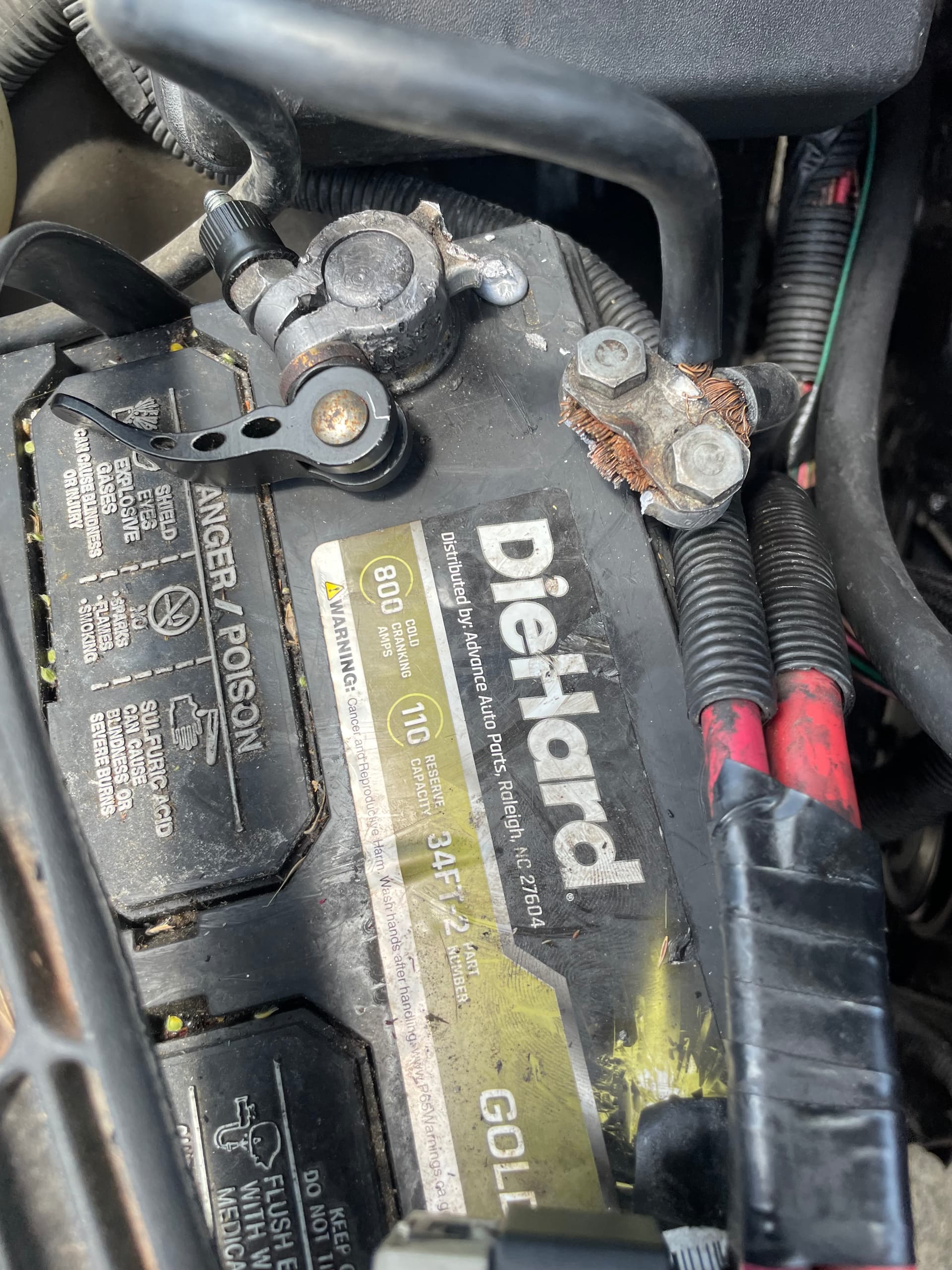

I have a 2006 Chevrolet Monte Carlo. It ran and drove great until a couple months ago then the signal wire on the starter shorted out, when the signal wire shorted out it burnt up the starter and since then it’s just been sitting.I have a new starter on it and I’ve wired everything directly up to the battery , so it doesn’t turn over with the key, the problem is that the new starter turned the motor over one time and now all it does is spin and won’t engage. I took the starter off and took it to AutoZone to have it tested. It tested fine so I put it back on the car and it still won’t engage. I’m not sure if this could be a problem from that signal wire being shorted out even though I’ve pulled The starter fuse and relay, When the signal wire shorted out, it melted the negative battery terminal so I’m thinking it could possibly be a bad ground on the other end of that cable. I would appreciate the help figuring out how to fix this

BTW in the picture of the negative terminal, it does not look like it melted, that looks like it was breaking and the last little bit as it was breaking arced and caused the little melty thingy…

My advice, get rid of those quick disconnects. Replace the terminals and clean up the wire ends. Twist the braid so it doesn’t flatten out like that.
