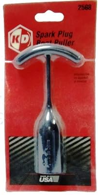

My plugs are overdue for replacement (I have about 50k miles on them). I managed to replace two of the rear three spark plugs in my 1992 Buick Century (V6), but not the third (plug #2). The rear boots are encased with a metal sleeve, but not the front boots. Is there any special tool required for pulling off the boots without damaging the ignition wires? Are there any special techniques for removal? I know I should replace the plugs themselves when the engine is cold, but will the boots slip off more easily if the engine is still a little warm? I didn’t have this much trouble in the past. Could keeping them in so long caused the problem? My left arm is still sore from trying to remove the #2 boot. Any advice will be greatly appreciated. Thanks.
There’s a tool called a “hose pliars” the looks like a long needle-nose pliar with rounded and 45 degree angled tips. Those are the best tool I’ve used. Harbor Freight Tools sells them, as do most automotive tool stores, but they’re not common in other stores.
There are a variety of spark plug boot pullers available. You just need to figure out which puller will work the best for your application.
Also, do not try to pull the boot straight off. Use a back and forth twisting motion as you pull.

A very handy boot removal tool from long ago was made by attaching a very small diameter tube to an air nozzle. It could be pressed down between the boot and wire and air pressure would separate the boot from the plug and then blow it free.
Agree with everyone else. Those can be a bear. The metal shield though just fits over the boot and nothing special. What I have used is a very long needle nose, like a 12" from Checker for about $10. They have straight and bent. Don’t remember which one I got but I should have gotten the other one. Allows getting a grip on it and still have some leverage to pop the boot off. Just as much problem getting it back on again. Might want to consider changing the wires at the same time instead if its been that long and for sure use the dielectric on the inside next time.
Every time I change plugs I also change wires. Don’t use Channellock pliers, it will smash the tubes and get them out of round. Also, just as OK4450 stated. Twist them back and forth and don’t pull them straight off.
