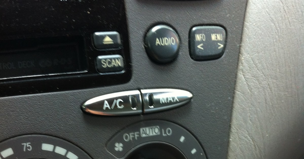

The AC on my 2002 Prius works fine, as long as it’s cool outside and I’m running it on low. As soon as I stress the system – either it’s above 75 degrees outside, or I’m running it on maximum, or driving on the highway for more than 30 minutes – the compressor conks out. Fan’s still blowing, but no cold air. The light on the a/c button starts flashing. If I turn it off for a few seconds, the cold air comes on again, but usually only for a few minutes, and then we repeat the cycle. The Toyota mechanics claimed they couldn’t replicate the problem, but I bet if I forced them to ride with me up and down the highway on a 90-degree day with the windows up and no a/c, they’d believe me. Any suggestions?

The blinking A/C light tells me the problem is electrical in nature. The control panel has requested compressor operation but it’s not seeing it. Seems to me I remember a technical service bulletin for Toyotas of this era dealing with a relay that would heat up and fail. Anyway, the fault could be anything electrical, switch, relay, thermal limiter, compressor itself.

The flashing A/C button is a warning that the compressor has locked or the belt slipped. There should be a fault code stored in the A/C controler.
" 1. WARNING FOR A/C COMPRESSOR LOCK
If compressor lock occurs during A/C operation, the A/C switch
indicator on the A/C control assembly starts blinking.
When this occurs, check for compressor lock (DTC 22) using
diagnosis trouble code check then proceed to inspect the circuit
or the component."
