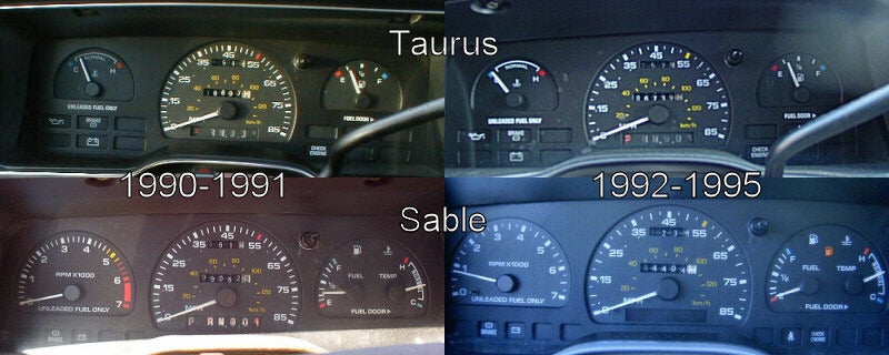

OP, are you sure you’re interpreting the gage correctly? Can you post a photo of the gage when the needle is in the area that’s causing you concern?
Are you sure your radiator fans are turning the right way, that is pulling air in through the rad and not pushing it out the front?
Picture at bottom right of this link is the gauge
Also, are you sure you disconnected it from the correct temp sensor. If you have a guage there should be one for the guage and one for the engine. I’m getting beyond my competence level but I think the computer will read the engine temp sensor so you can see if it really is over heating or use the infrared gun on the radiator/engine. Sure sounds like an electrical issue instead of a cooling issue though from the weird symptoms.
When the needle hits N or O on NORMAL it’s hot. The link shows the gauge
As far as I know there is only one on the sable. And it’s mounted directly on the thermostat housing.
Are you sure? I don’t see N O R M A L on that gage. OOPS! I see it now. I had to zoom the photo.
The N and the O are within the normal range still. And it would not be unusual for an engine to run warmer with the A/C on. The compressor places a lot of load on the crankshaft.
