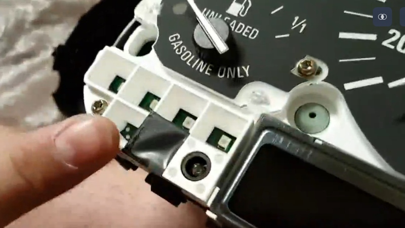

Perhaps a pre-purchase inspection could have saved him from this mess
Poor guy!
When is Washington going to pull that “dealer”'s license?
I wonder if checking for codes in the absence of a cel is still done in as a standard practice for pre purchase inspections. It is possible whoever owned the car previously did the tape over the light.
Sounds very shady . . .
AFAIK . . . a dealer is not allowed to sell a car with the MIL on
Somebody obviously put the tape over the MIL
I suppose the dealer will probably claim that they knew nothing about the tape . . . maybe they’ll even “imply” that whoever owned it before must have taped over the MIL
Agreed . . . a pre-purchase inspection would/should have saved the buyer from a grim fate
I’m confident many other members also do this. When I turn the key to “ON” I do a quick scan of all warning lights to make sure they are functional.
Washington state emissions testing no longer checks for a functioning check engine light. To pass state emissions inspection the car (1996 and newer) simply needs to have all the I/M monitors ready for testing and no fault codes stored.
Without knowing what fault codes were present, I can’t comment on whether the check engine light is related to the engine failure.
But yes, I always recommend that people have a used car inspected before purchasing.

why did motor die? Misfire? Cel light won’t warn u of low oil pressure. U can feel a misfire. Motor was ok prior to death? What codes are stored?
Cavell: I would also like to know The “mechanic’s” actual diagnosis. The purchaser could have easily been scammed twice ($18,000 to rebuild engine???).
Too bad that the story did not provide more information about the correlation between an inoperative CEL and total engine failure.
I wonder what warning they’re referring to.
It would have been nice, had the article included what codes “Were” stored on the computer.
This would give us a good idea of what someone was trying to hide.
When ever I buy a used car I always check that all the warning lights light up when you turn the key to “Run”. I would think that the dealerships person that inspects the trade-ins would have looked for that too.
But Some real small dealerships may not have that qualified of a person under their employment.
Yosemite
What CEL codes could result in “the engine completely failing”, as the article states?
Either there was something already weak with the engine, or the person diagnosing the “failed engine” is making a misdiagnosis.
I wonder if the engine was a massive oil burner and the engine failed due to lack of oil and the inop CEL and fault codes had nothing to do with the failure.
Another theory could be loss of engine coolant which roasted the engine and the CEL may have had something to do with that.
All theories and as usual with journalism; lacking details.
With an engine price that high, it might be an M5.
I will also agree with others that there is the possibility of a faulty diagnosis of a failed engine.
What is not known is whether the engine is seized, knocking, has a rod thrown the block, oil light on, or whatever.
