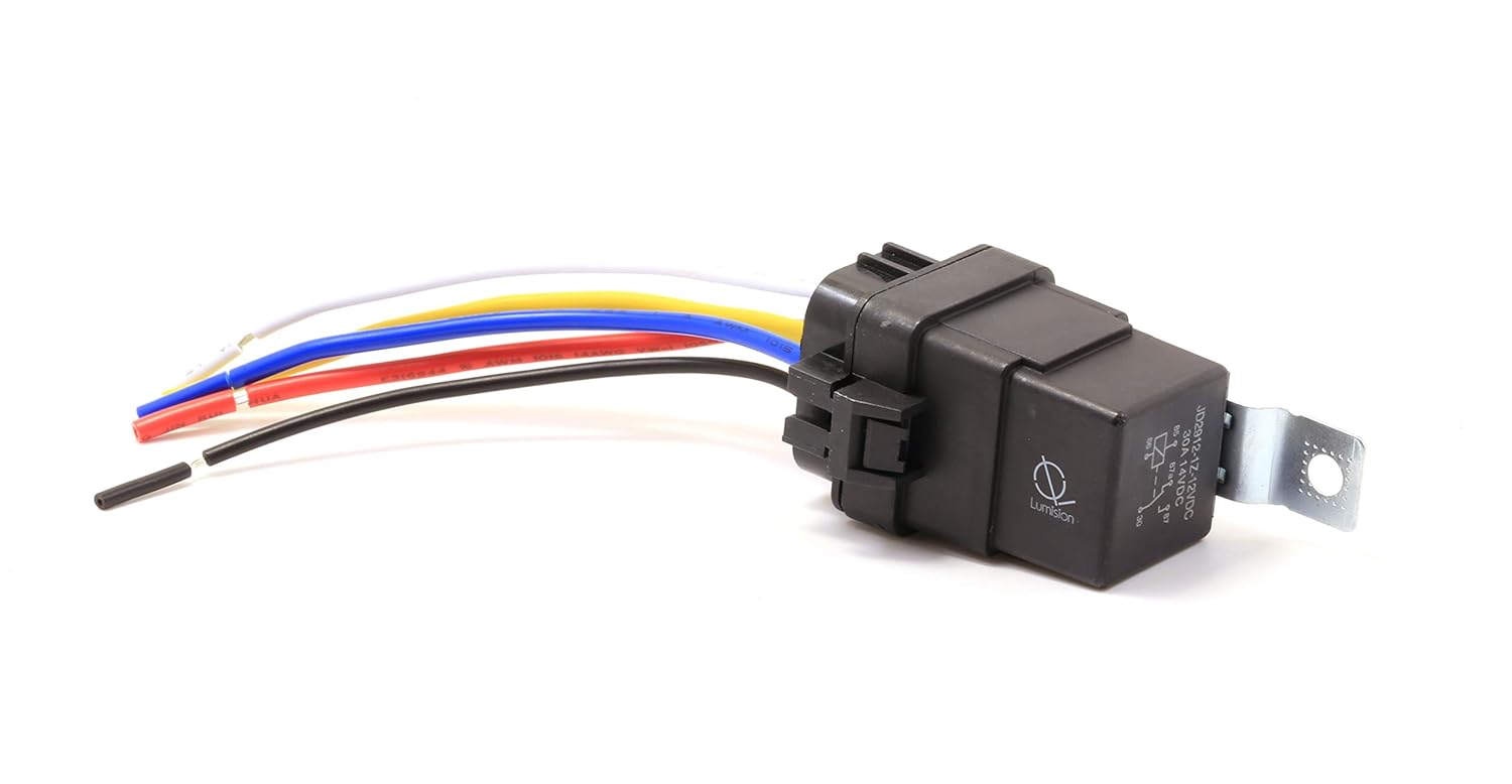

If the problem is a broken or damaged wire, or loose electrical connection/cracked solder joint in the fuse/relay box, I would locate and fix it (or replace the fuse/relay box if it’s unrepairable). If the problem really is the PCM, I would not attempt to replace the PCM. I would find a circuit which is energized when the key is in “ACC” or “ON” and tap into that to power the coil of a relay (NOT the actual fan) and connect one of the load terminals directly to the positive battery terminal (making sure to put an appropriate fuse and fuseholder as close to the battery as possible), and connect the other load terminal directly to the fan high speed. This will allow the fan to run whenever the vehicle is in use, so you don’t ruin the engine, and the fan will turn off when the vehicle is not in use, so you don’t drain the battery.
Edit: Here is an example of the type of relay to use, which includes a waterproof socket with pigtail leads. Note that this is just posted as an example, and I am not connected to Amazon or this seller in any way, and I don’t necessarily recommend this brand.
