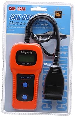

I got a basic scanner at Pep Boys a few years ago for about $40.00, just saw one on Amazon for $30.00 I have used it several times on my old car and also helped friends out. So far my simple scanner has always read the codes and reset them when appropriate. Advance, Auto Zone and stores like that sometimes still will read codes on your car for free hoping to sell you the parts to fix it.

Do you know the name of your scanner? The automotive stores in my town don’t have OBD I scanners. They’ve all moved to OBD II. The ones that I have seen for sale are over $100. . .
Amazon has U380 OBDII Check Engine Auto Scanner Trouble Code Reader for $30.00,
I should have read a bit closer, the OBDII readers are inexpensive, the OBD1’s are pricey. Sorry about the confusion
