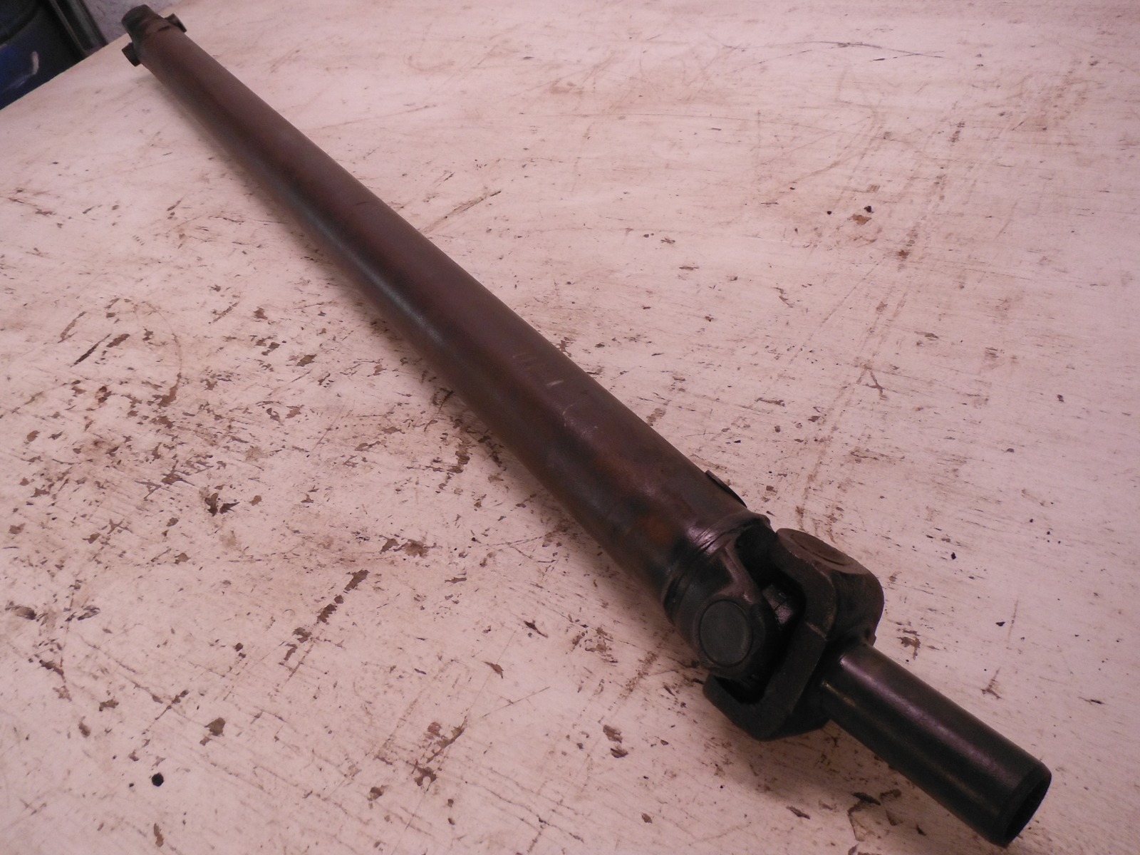

Here’s what the front of the drive shafts I’ve worked on look like. What cars did you have?

Geez, 5 pages for a driveshaft R&R…I’ll go out on a limb and say there is no way that the driveshaft can’t move forward enough to drop the joint out of the saddle. That would be an interference fit on the slip yoke and the tailshaft housing would be cracked by now. It has to slip pretty significantly just to accommodate the rear end motion under normal use. More than enough to clear the Ujoint. You just have to pry both caps from the diff yoke and that is going to require a big pinch bar if they’re stuck. If you support the body with jackstands with the wheels off the ground, the rear end will tend to point downward in the front and give you a bit more room to slide out the shaft.
@wesw - you’re right for 2-piece driveshafts, but all the 1-piece drive shafts I’ve worked on look like the photo I posted. That applies to most rwd cars with live axles, I think.
