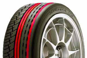

As CD would say, ‘That’s not a tire stripe! This is a tire stripe!’
http://di1.shopping.com/images1/pi/4f/c4/fa/44824353-177x150-0-0.jpg

Wow. Those tires must have come from the nonprofit “tire manufacturing factory for the visually impaired”.
