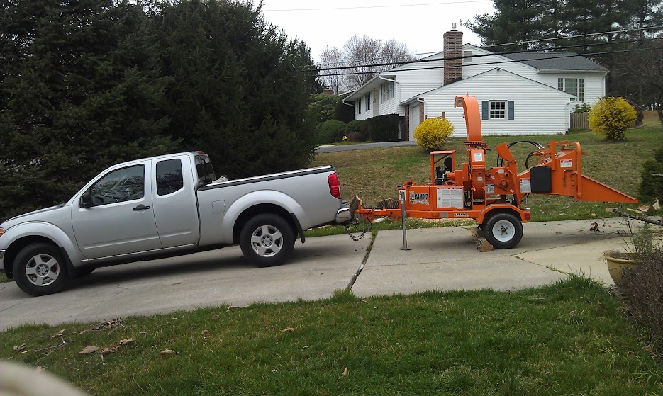

https://lh6.googleusercontent.com/-KfhMpPxbyq0/T2ihCRIM2uI/AAAAAAAACoY/MM5OuXkhXYw/w935-h559-k/2012-03-20
UncleTurbo – No grind. 4L V6, 6sp manual, 6300lb rated towing capacity. However overrated that may be.
Missile – Nissan Frontier. Chipper weighed ~1900lbs – a weight I’ve towed before with no problem. Whether it is safe or not is another matter.
