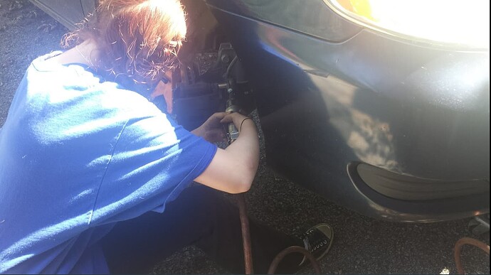

Another thing, no disrespect, but are you strong enough to properly tighten the caliper bracket if you replace the rotors and then the wheels??
If unsure, then you will need a torque wrench to confirm you have it properly torqued, it is always a good idea to use a torque wrench when tightening lug nuts… My petite daughter has done a few brake jobs, including a friends, I always supervise and go behind her to confirm the bracket bolts are tight enough…
