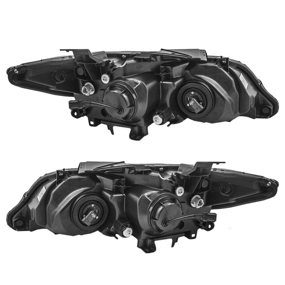

If it’s the low beam, there’s a cap to remove first. A small twist (maybe about 1/8th of a twist) turns it where it can be pulled off. It can be very stiff and also hard to get a good grip on, and without much space, you can’t get a good angle for leverage. Try gloves, since the plastic digs into your fingers and since it’s hard to get a good grip, and muscle it off.
If it’s the high beam, it’s not what looks like a rubber boot to remove. Just a small twist of the back of the bulb itself, and one twisted where the tabs and notches line up, pull out.
I’m not sure if the deep link here will work, but here’s a picture of the back of the headlight, probably similar to yours. Look closely, toward the middle is the cap/over over the low beam. Off to the side, the back of the bulb for the high beam. Link is: https://res.cloudinary.com/brocksupply/image/upload/7221-0112LR_2.jpg
See also another thread about dim low-beams on the 2013-2015 Acura RDX. There’s a chronic flaw in the Acura RDX that should be a recall. I’m not sure if it affects the CR-V. If your issue is low beams being really dim, even with working bulbs, you may have the same problem.
EDIT: The CRV looks like it has a different headlight assembly (good for you!). The twisting and manpower suggestions may still apply though.
