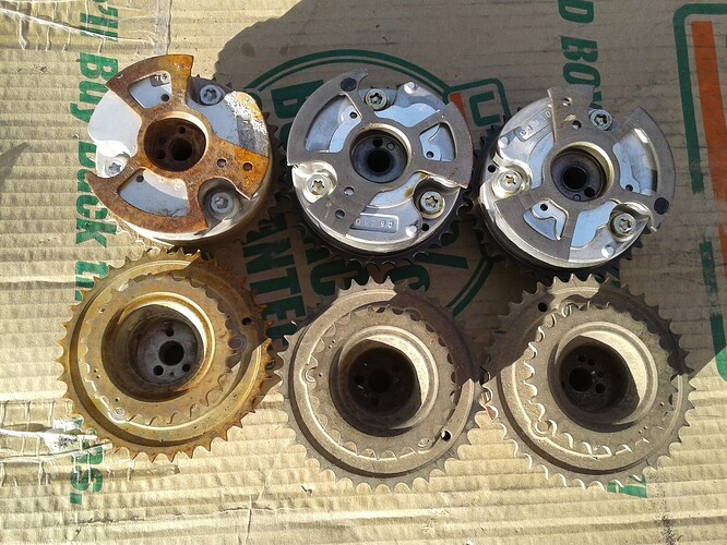

He had it towed again to a shop that I use. They diagnosed it as a failing VVT-I system which will trash the engine when it completely lets go as the 3.5 are interference engines. It sounds like this is a labor intensive fix and a known problem with these engines of that era. I am kinda surprised a Toyota dealer just threw a couple grand in parts at it and didn’t investigate the timing, especially knowing the mileage and the engine involved.

If I were to do this, what other parts should be changed while I am in there? It looks like the water pump is one part that you always change if you get in this far but what else? Also, would replacement VVT-I parts be an exact replacement or would the flaws in the original design be fixed? I guess another option would be if one could get a decent used engine from a 2013 or newer and swap it in. I assume that this would work by swapping the accessories.

I have replaced many Toyota variable valve timing actuators (camshaft sprockets), routine work for experienced Toyota technicians.
