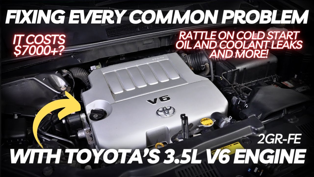

This guy seems to really have a thing for Toyotas and speaks highly of them. This channel comes up anytime I look up something on the Highlander or 3.5 engine and it seems he mainly works on Toyotas. I am thinking I am going to proceed with the repair as it will be around $3000 with parts and labor. It is in far better shape than the ones in these videos but I will let the mechanic take a good look at it before I commit in case there are some hidden surprises. I know the history and it has always been taken care of so if it is just the VVT-I, and associated fixes, that would be great. I might have him change the alternator and power steering pump while in there as this engine is really tight in the engine bay. It sounds like you are ■■■■■■ to not change the water pump and the shop has that in the price they gave me. I am thinking the head gaskets are overkill but it looks like the labor to do them at the same time as everything else is not much more. I will ask the shop if doing what is done in the first video is a good idea or not. Unless there are some surprises, this seems like a good car to have around.

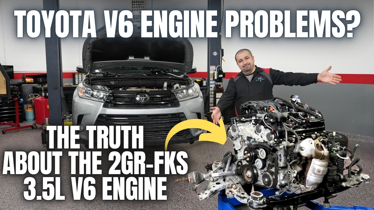

One of the videos I found answered one of my questions. Yes, a better 3rd gen timing setup can be installed on a 2nd gen engine, essentially solving the VVT-I problems of the 2nd gen. That being said, it sounds like that would be a costly upgrade unless known good used parts from a 2014-2016 could be found. It would probably be worth doing this if the car was essentially new but figure it will be worn out by the time this engine component wears out again.

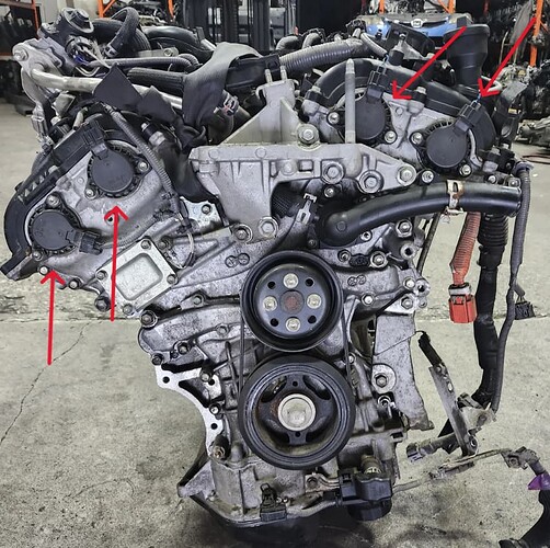

From a 2GR-FKS engine as shown in the video? That engine uses electric camshaft actuators located on the front of the engine. You would have to replace the cylinder heads, computer, wiring harness etc.
The 2GR-FE engine in that Highlander has hydraulic camshaft actuators. Dirty control valves cause sticking actuators. You are making a big project out of this.
Yeah, that is a 4th generation in the video if you want to call it that, not a 3rd gen. The 3rd gen is not as different as this one and the job would be much easier. That being said, it is probably not worth doing unless there is a known good donor for not a ton of money. He discusses all the evolution of the 2GR engine in this video.
