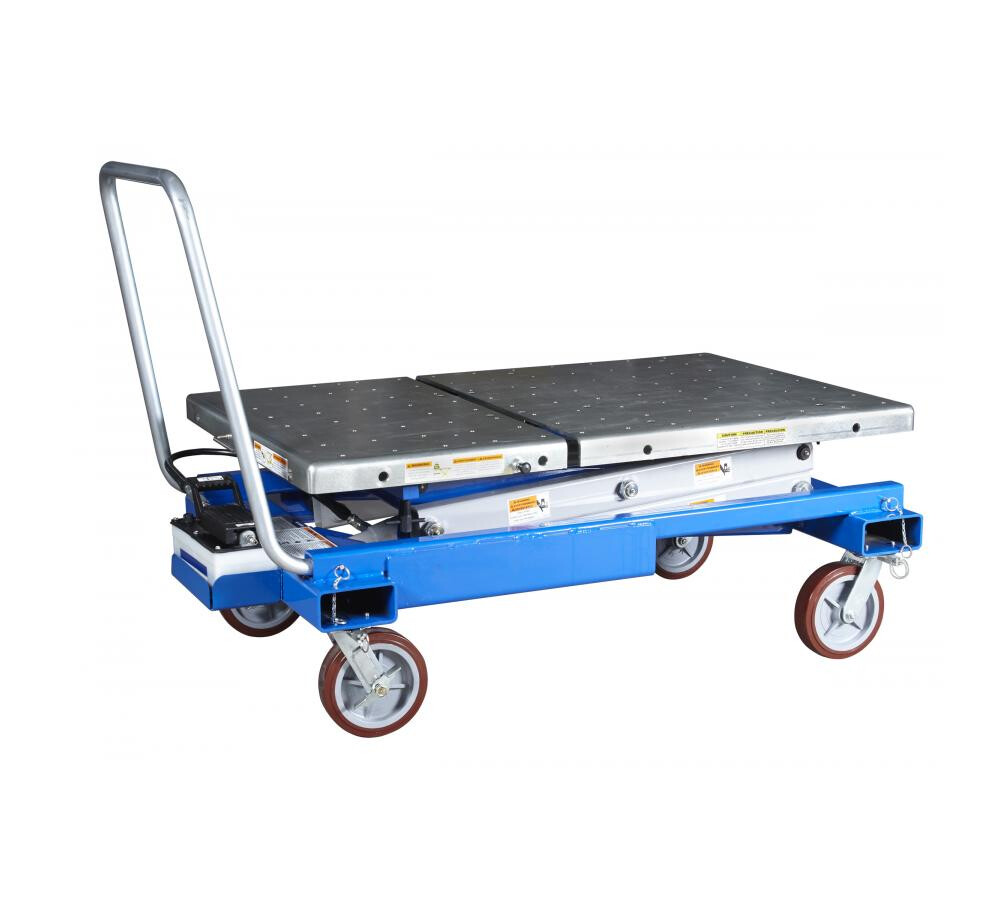

A $13,000 lift table for removing heavy high-voltage batteries was delivered to the service department before the new electric vehicles arrived. Prepared for the future, one lift should be sufficient for now if batteries should last 20 years.
