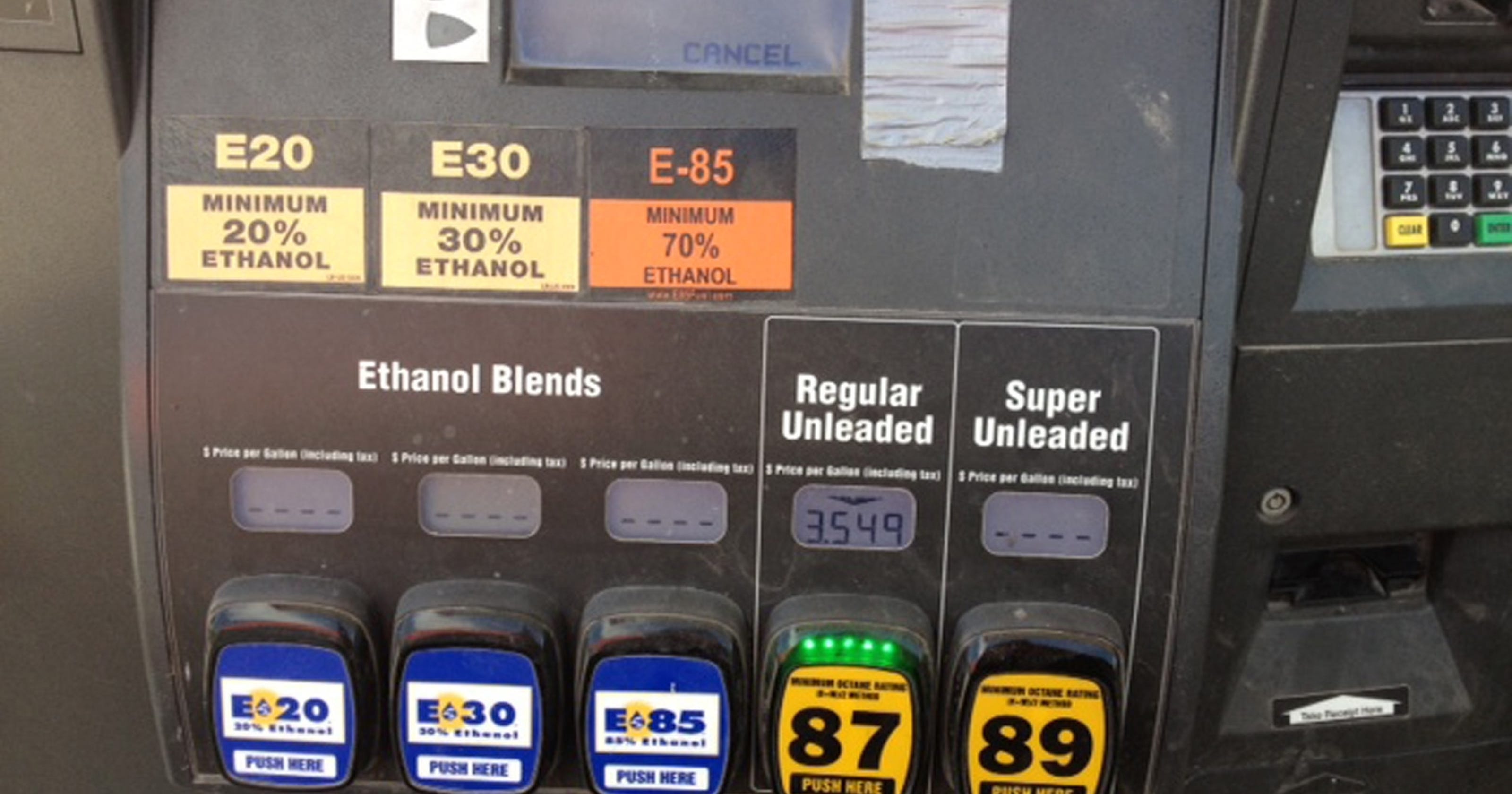

We don’t even have E85 in Central Maryland. I think E85 is a Midwestern thing, and those that do buy it there do so to help corn farmers. That is a guess, of course, since I rarely get to the Midwest. Maybe Midwestern posters can tell me whether E85 sells much here.

I have a 2017 Toyota 86 (formally the frs) not only does the book say no Higher than 10% E it also says it on my gas cap. But I’m sure most new cars also say on the gas cap as well. I live in Nevada more and more E15&E85 pumps are showing up. Instead of the E pumps I would much rather they put at least 93 octane regular gas in my state. As it is I have to mix 100 octane pump gas(approved for cars not avgas) and 91 to get 93 octane. This gets pricey as the 100 is 7.99/ gallon.
I wish they would stop making stupid blended gas as well summer and winter. If they would stop doing things like this gas would not only be better for the planet but cheaper as well. Plus it’s common knowledge that E gas hurts the cars if it didn’t all cars could run it no problem. Look how long it took us to realize what bad effect TEL gas(leaded gas had not only on us but the planet as well)

It’s has a do not use E15 or E85. If they want to push E products then it should have its own gas station that only carries E gas. All the rest of the gas stations should have non blended E free gas. Let people make there own choices what to use. If it is really better then they will sell more. But making all gas have a min of 10 is bs. If you are lucky to have a station that you can get E free do it. Save your car and trips to the repair shop or junk yard.
thats nice at least you have a choice if I could get E free 93 out here I would drive to get it even if it was a little more expensive.
The problem is that ethanol free fuel is it isn’t just a little more expensive. It is a lot more expensive, sometimes as much as a dollar more per gallon then E10. It is probably heavily taxed as well.
