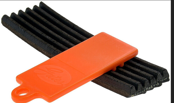

Technically you are supposed to use one of these to measure wear…
But serp belts last much longer than people want you to think they will, if it is not fraying or making noise, run it…

You can’t tell the condition of a serpentine belt by looking at it anymore.
Belts today are made of EPDM rubber and don’t show wear like neoprene.rubber belts.
Mine in the picture above was EPDM rubber… EPDM rubber also last much longer than the serp belts from the 90’s…I have seen a lot of belts still being used long after failing the wear check using the proper tools..

I’ll say it again, You cannot determine the condition of a belt that’s made of EPDM rubber by looking at it.

If not squealing at start up or when raining, I’d run it and put your limited funds towards your check engine light being on, and or spark plugs (OEM not OEM like) if time or required… Other than with mechanical failure of another part, I don’t remember seeing to many, if any EPDM rubber serp belts breaking, most of the time they will squeal like a pig before anything happens to one… Not saying it doesn’t happen, just saying it is not very common in my part of the world anyway, and I used to see from 20-75 vehicles a day depending on location…

I’ve got that plastic gauge for checking belt wear. Problem is getting decent access to th3 ribs. At any rate, I usually have them replaced about 50-60k even though they are not worn out. I don’t like surprises an$ rarely find myself at a shop for other work. So whatever fits my schedule. Now when buying a used car, I spend a little time and money bringing, belts, hoses, fluids, brakes etc. up to par so I know what the history is. Just part of the cost.
