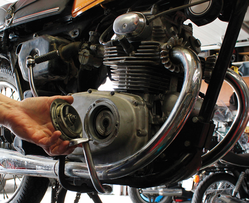

Honda used centrifugal sludge traps on their old air cooled twin motorcycle engines.
