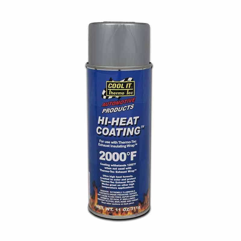

If it still bothers you (and I know it does), just buy a can of this:
Wire brush the rusty areas then spray it with this when the mood strikes you.
