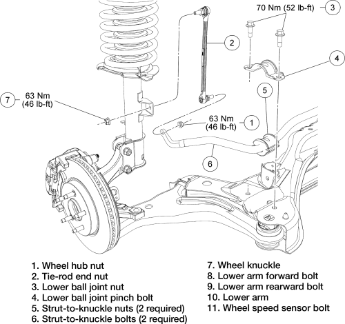

However, according this diagram, he upper control arms have eccentric bolts for adjusting the camber.Items 6.
That picture is not a 2002 Ford Escape. The 2002 Escape front suspension is a coil over strut with a 2 bolt clevis attachment to the knuckle. And the bolt holes in the clevis bracket allows about 0.5 degrees of camber shift
https://www.autozone.com/znetrgs/repair_guide_content/en_us/images/0996b43f/80/e4/2c/a5/medium/0996b43f80e42ca5.gif
This looks to be an Expedition SLA with torsion bar spring.

Based on this…
