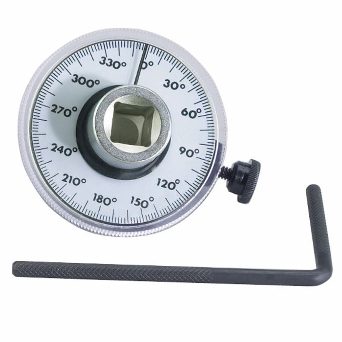

To set the torque angle requires a torque angle gauge http://www.sears.com/shc/s/p_10153_12605_00994203000P. You mount a socket to the bottom of the gauge then a breaker bar to the gauge. Position this on the bolt and then zero out the gauge where the stop bar rest against something. Now tighten the bolt until the proper angle is reached.

The best way to get the proper torque angle is with an angel gauge like this, available at most auto parts stores. Don’t forget to add a touch of oil to the bottom of the heads of the bolts. http://contentinfo.autozone.com/znetcs/product-info/en/US/otc/4554/image/8/
