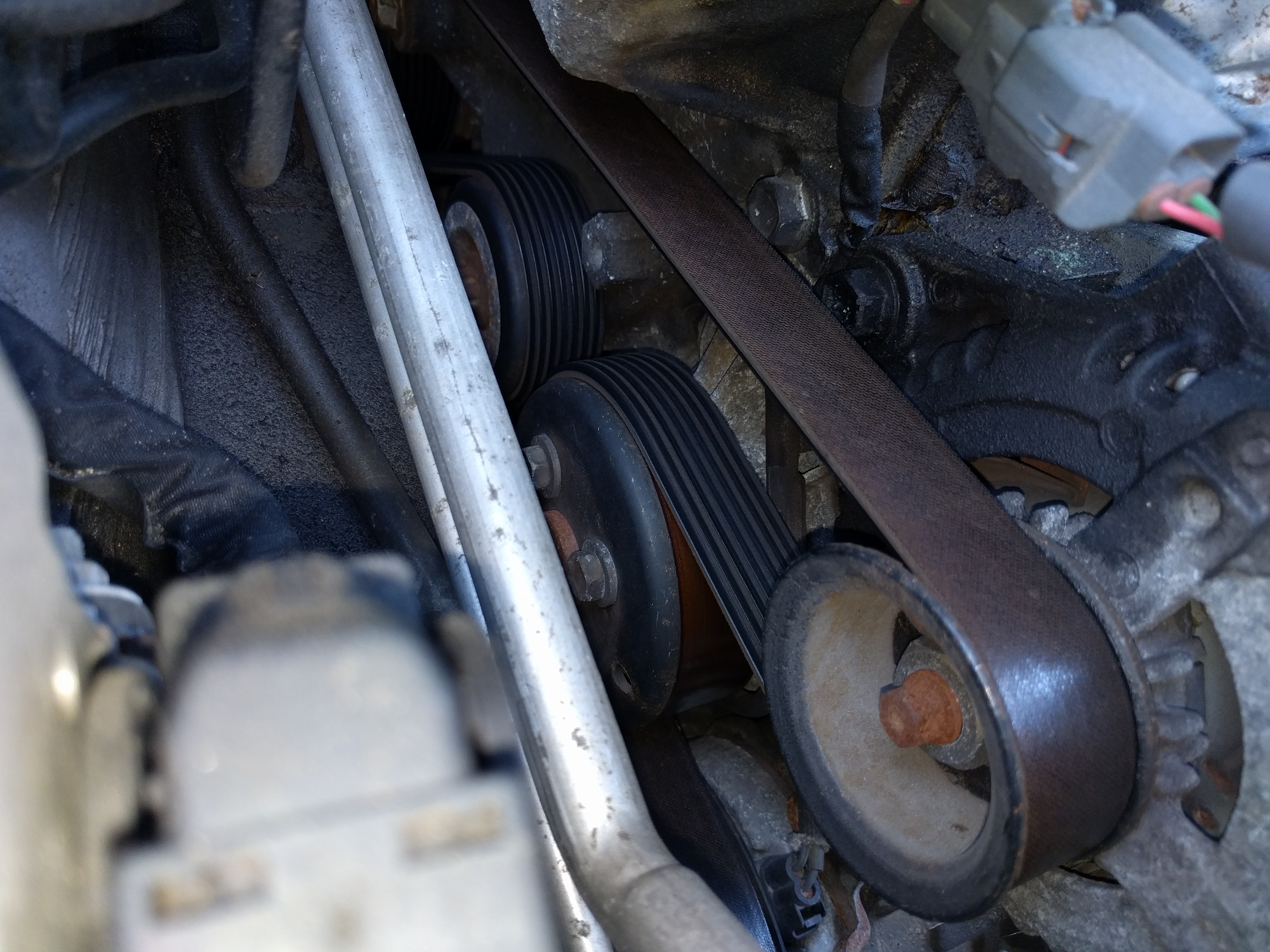

I’ll post a picture of my current belt, just to keep everyone up to date.
Also, in case anyone wants to see what a good (or bad, I’m not sure yet) belt looks like.

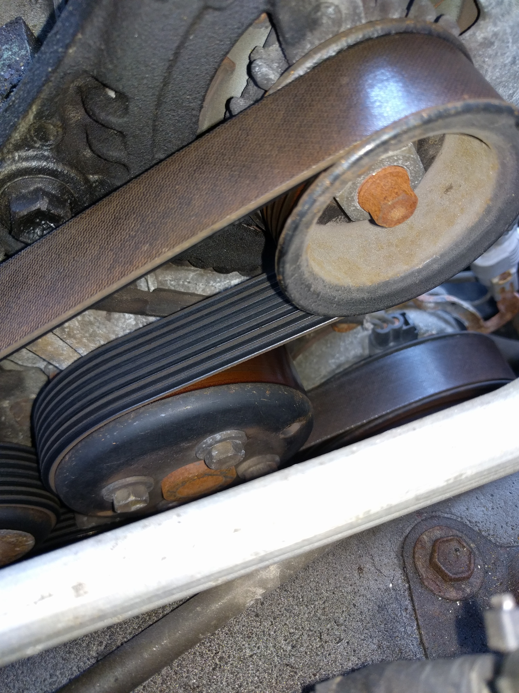

Another photo
Sorry Douglas, but saying a belt is good or bad from a photo is not realistic at all. I thought you were going to have a mechanic look at it.
I absolutely am going to take it to a mechanic.
I’m just posting a photo so others can see the belt. Then when I hear whether it’s good or bad from the mechanic, I will be able to post it here to let others know
Your belt looks old and glazed, and considering its age and mileage, I’m not surprised
I’d just replace it. You got good usage
Your dad can probably help you get that done

Their response was that the outside of the belt was glazed, but the inside (with the ribs) is still soft and is not cracked or missing chunks of any ribs.
Both garages told me that it doesn’t NEED to be replaced right now, but it will need to be replaced at some point in the future - which I’d say to be a few months.
Aside from this, there is one issue that even I didn’t see coming. The tensioner is seized, which was a fairly expensive repair when the Toyota dealer gave me an estimate on the total of the replacement parts.
To get that done, I’m going to take it to a garage in brampton. He is significantly less expensive on his parts and labour, and I have never had any issues with him in the past.
In the end, seems like it’ll be just fine to take it on this long road trip.
Replace the belt at the same time the tensioner is replaced and you are good for some time.
