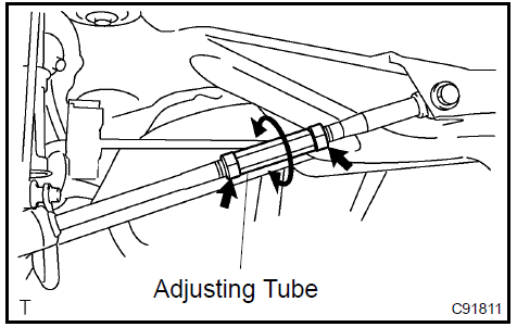

Yes that thing. Adjusting it is weird. I can’t find any specs as to how long it should be. So I just kept messing with it. Mine came apart in two pieces when unscrewed all the way.
Ok that makes sense. I just didn’t want to be charged for diagnostic at the alignment shop.
You can, for a base line, measure the other toe bar (rear rearward adjustable control arm) and adjust this one to match, just need to have equal turns on both ends (inner/outer)… Then install and if the wheel is still way off then you are missing something… But the toe bar will require an alignment to be in proper spec…

I just want to ask a clarifying question, is that rear control arm adjusting toe or camber? After some research, I’m confident I can do the toes on the front tires when comes time.
What’s not practical about opening the package with the new part and comparing it to the old part you just took off the vehicle?
I do this at the parts store when I buy local. I don’t skip that step just because I bought it online and the parts tool said it was a match. Trust but verify…
Technically it is a control arm but it could also be described as a toe-link.
That adjustment is for the toe. Same adjustment on Highlander, Lexus ES350, RX350 etc.
Kind of like a turnbuckle, with lock nuts at each end.
