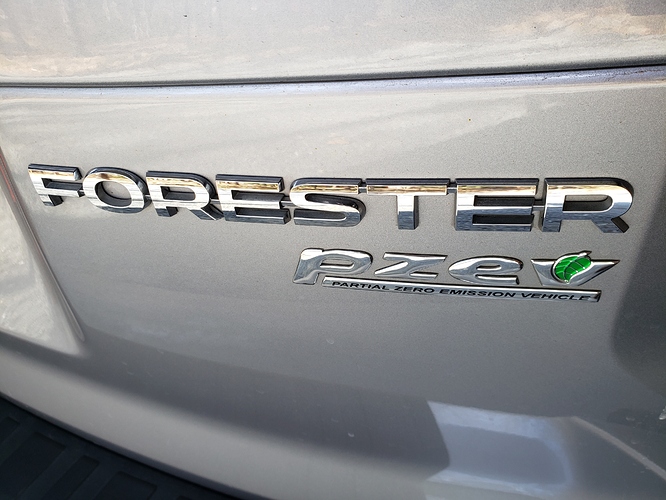

How exactly do you achieve “partial-zero” :question: Either you emit something or you don’t. I always thought of zero as nothing.
OK. so it’s nothing but word play. In the real world zero is nothing, and there is no such thing as partial nothing.
I understand LEV, ULEV, but partial zero is a misnomer, and an oxymoron.
The Partial Zero Emission Vehicle was a compromise arranged 20 years ago when it became apparent that vehicle manufactures would not be able to supply electric vehicles as required in the state of California. It was a government requirement 10 years before it was practical, GM spent 1 billion dollars on the EV1 project. A little bit of something is better than nothing.
Same as vodka, it is partially zero alcohol. 40% alcohol, 60% water.
The PZEV designation was so California didn’t “lose face” for requiring unicorn cars that no manufacturer could sell.
GM’s EV-1, contrary to the movie Who Killed the Electric Car, did not have enough buyers. And GM lost a lot of money on every EV-1 leased. Other car makers didn’t even really try.
It’s good to be skeptical of the EPA ratings. However, PZEV in terms of the EPA definition is much more than wordplay. PZEV certified vehicles emit dramatically less smog-causing emissions than the legal maximum for their model year. The ones on sale today meet the much stricter 2025 EPA emissions standards now. The OP mentioned smog. PZEV-certified cars were specifically designed to reduce smog through evaporative emissions as well. They have added emissions system components and the catalytic converters are different (close-coupled). They also do two additional things that conventional cars do not. They heat up the catalytic converters more quickly. Cars are their dirtiest before the catalyst is hot enough to work. They also have lower emissions in the immediate period after a car is shut down.
