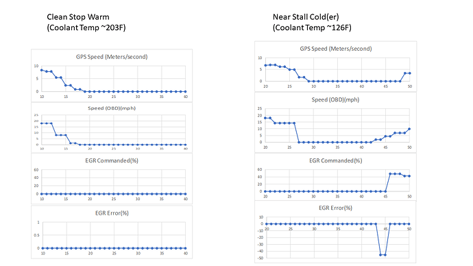

Got a bluetooth OBD and Torque Pro and logged my commute this afternoon. Attached are some charts comparing a clean stop when the engine was warm (end of the drive) to a near stall just as I was pulling out of work. I think a bunch is just the effects of the near stall but not sure. One thing the got my attention was a fair number of EGR error readings? No codes or warning lights are coming up though. Should that pretty much always be near 0% error all the time? Any chance I just need to clean the EGR valve?
Any other recommendations what I should be logging? Right now I’m logging enough that it’s only updated every 2 seconds (Note… I definitely dropped lower in RPM on the near stall than that data shows - probably just under sampled) - So any recommendations on what’s important so I can limit what I lot and it should increase the update rate…
Any idea?
Scratch that… only letting me attach one image - here’s the long term (30 minute) EGR Errors
