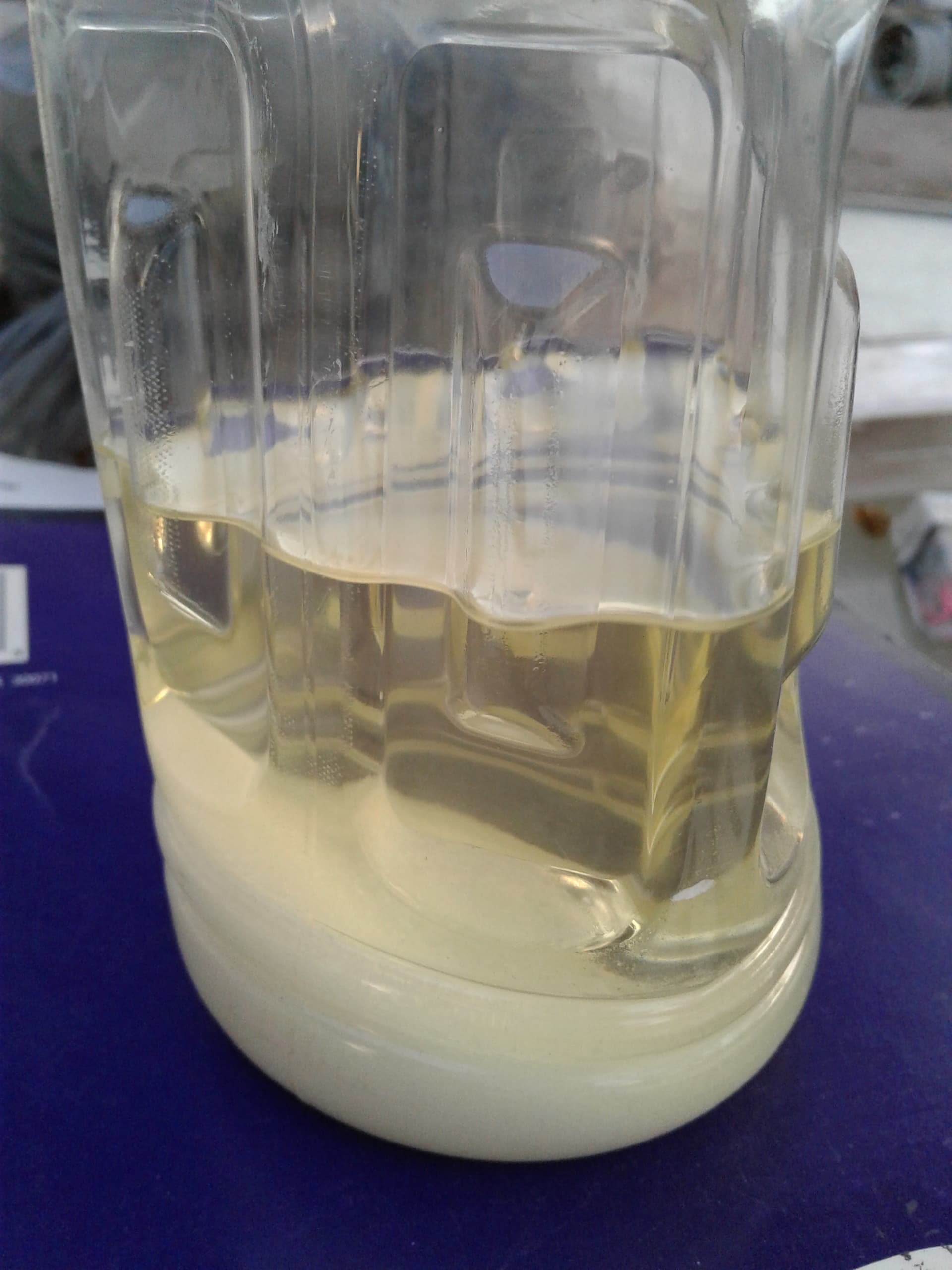

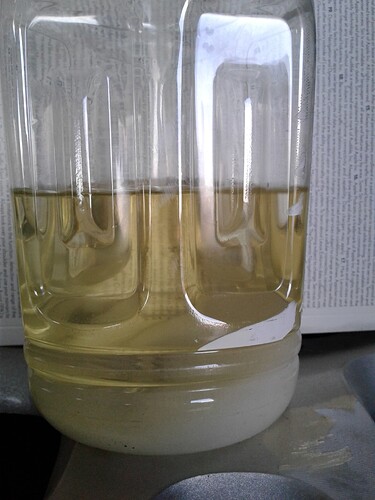

3 years ago, I added a few tablespoons of sugar to 8 ounces of gasoline, this is how it looks today; the sugar has not dissolved.
What kind of container is that?
Plastic beverage container.
The gasoline didn’t dissolve it? Went through a Dixie cup in about 2 minutes.
Dixie sells paper products, you didn’t specify what your cup was made from.
Polyethylene terephthalate (PET) bottles are not recommended for gasoline storage, but it is more durable than Styrofoam or paper.
The plastic cups that are red on the outside that people use at parties for soda. Maybe it wasn’t Dixie I can’t remember.
I put 1/2 a teaspoon of sugar in about half a cup of gasoline. It still isn’t dissolved. Maybe the sugar needs to be mixed with water first.
