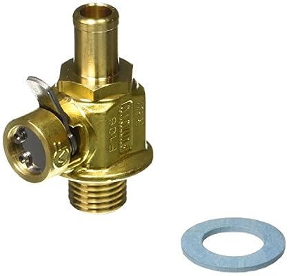

I’ve never used one of these drain valves, but it’s an option for you. It installs into the oil pan threads permanently, so it doesn’t need to be removed with the chance of further thread damage.
You would need to make sure that your drain plug is located in an area with enough clearance to accommodate the valve.
