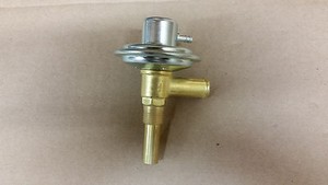

Maybe one of these
http://shop.advanceautoparts.com/p/carquest-or-factory-air-manual-shut-off-valve-84706/5652952-p?iv_=iv_p_1_a_214327102_g_12425515822_w_aud-48102772055:pla-191564126662_h_9013798_ii__d_c_v__n_g_x_pla_y_6201684_f_online_o_5652952-P_z_US_i_en_j_191564126662_s__vi&utm_source=ACQ&utm_medium=cpc&utm_campaign=PLA&utm_content=shoppingcampaigns&gclid=Cj0KEQjwx96-BRDyzY3GqcqZgcgBEiQANHd-nh9ZYRf8UApzGgMphV8K2fRvviSYr43leRwd9iIs1KsaAum-8P8HAQ
is in one of the heater hoses

There are heater control valves for '52 Fords and Mercuries on Ebay, with a vacuum port on top.

Thanks for the interesting feedback. I see the photo in @texases post above of a vacuum operated valve of some type. This seems sort of overkill for the heater coolant control valve, but maybe it made sense in 1952 … lol …

Isn’t that the way it goes sometime!? The vacuum operated valve pictured above is what I have in the car engine compartment. When I looked at it yesterday I noticed that it is in the lower hose coming out of the heater core, but that hose is connected to the water pump so maybe it is correct? For now I’m going to assume that the valve was stuck and came loose somehow.
