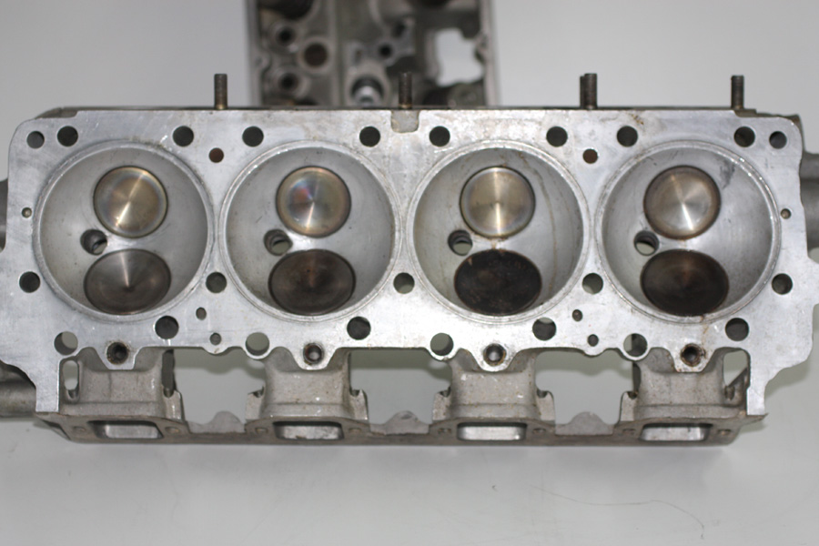

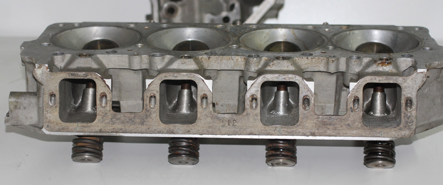

Does the modern Dodge “hemi” engine really have just a simple hemispherical combustion chamber? Probably not.
I wouldn’t be surprised if a modern car could meet the 1975 emission limits without a catalytic converter.
“Does the modern Dodge “hemi” engine really have just a simple hemispherical combustion chamber? Probably not.”
Nope, it’s more of a ‘semi-hemi’. A full hemi really isn’t the most efficient way to go, what with fuel injection, and the need to minimize the surface area to volume ratio…
New:
Old:
Just some worthless trivia, but Harley has had production hemis since 1936 (excluding the 1935 prototype and '36 up sidevalve models) and still use them today with fuel injection.
