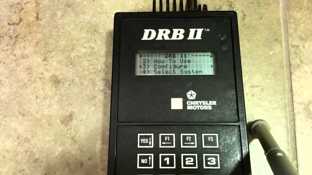

Chrysler’s DRB II from the late 1980’s shown below. The display shows live sensor data. Actuator tests can command computer outputs to switch on/off.
There are separate cables to connect to the engine or Transmission/ABS/Body computers. A cartridge allowed for annual updates or to adapt to Mitsubishi, Jeep/Eagle vehicles.
The DRB II is 100 times better than the Actron scan tool I own.

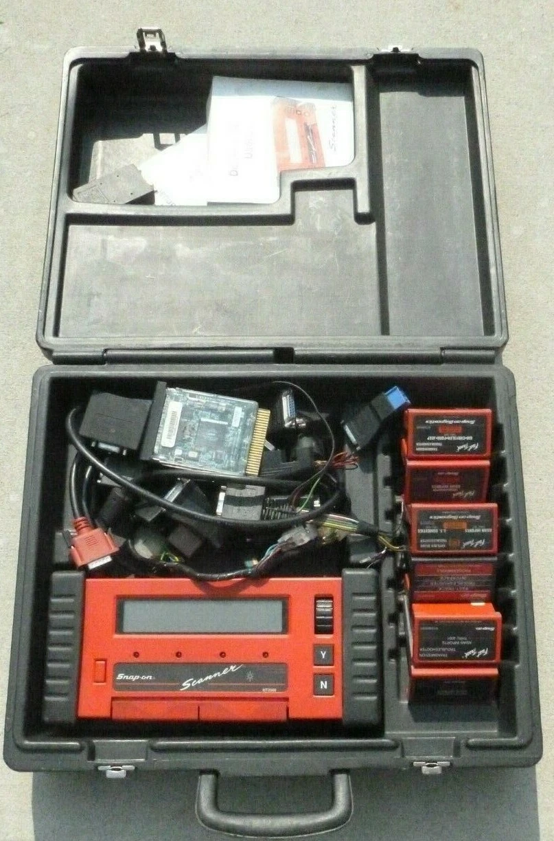

I had the old Snap on Brick (MT2500 scanner) with the 2 cartridge slots, and a whole bunch of cartridges and cables plus a couple of generic cables, it was a great scanner way back when…
I remember getting the new OBD2 cartridges and cable for it, the 1st vehicle I used the OBD2 stuff on was an E150 and I laid the scanner on the wiper arm and put it in the key on self test thingy mode and was half paying attention to it when the wipers started working and I caught it before it hit the floor, I was thinking WTH was that… lol… Haven’t left a scanner on the windshield since… :laughing:
Picture from eBay…

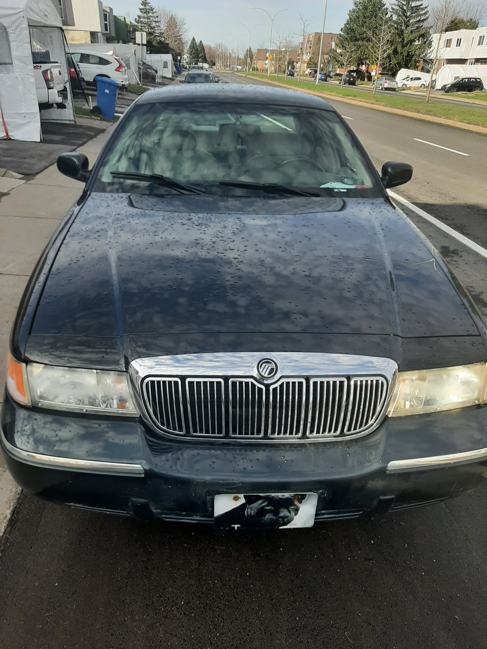

My 1999 Mercury Grand Marquis (71000 miles) is very reliable but as my brother says it won’t break down in my driveway. Previous 93 Crown Vic LX 150000 miles very reliable. Easy to work on these Panthers with so much repair help online.
Agree Fords are reliable. Buy my batteries at Costco with low price and great warranty. But they don’t install them. But how difficult is it to install a battery?
Battery replacement is one of the easiest jobs there is.
Your car is 25 years old, but only 71,000 miles?
Yes and no rust as it was sprayed with oil every year.
Original owner was a retired gentleman.When he could no longer drive, he gave the car to my brother who used to do oil changes and maintenance for him. So he got the car at 31000 miles.
I inherited the car in 2015 and now it is at 71000 miles.
I did not have the space to keep two cars or the energy to self maintain two cars so I let the better equipped Crown Vic LX go.
