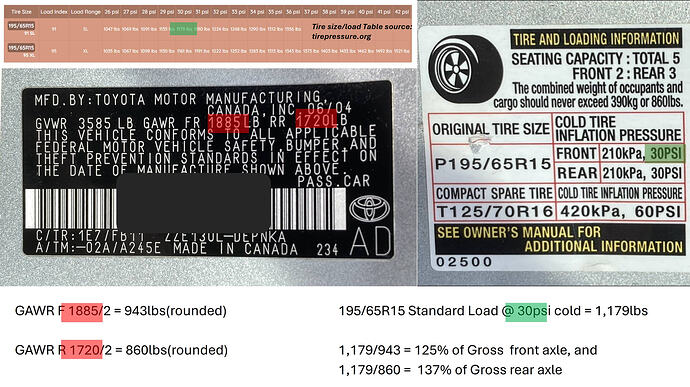

I bothered to run the calculations myself, for my 2010 Honda. The same can be done for anyones’ ride here:
As you can see, Honda, at least, did their homework. The cold spec pressures satisfy, front and rear, at least 110% of gross axle and thus vehicle load. That’s 5 adults, full trunk, full gas, and the dog. - a situation which occurs quite rarely in my case.
There is no practical reason for me to maintain cold presures of more than 1psi over the specified 32 with the OE size and standard load tires installed. If I go XL, according to the inflation table, I can optionally inflate to 33 or 34psi cold for equivalent load capacity.
Car will handle and ride fine, in either case.
For a Toyota 2005 Corolla:
Woahhh - that’s some margins! Ideally, I could run pressures in two alternative ways:
29psi all around,
or:
30psi up front and 28psi in back, and still statisfy at last 115% of gross(the most I could ever carry) load.
Toyota probably specified 30psi all around for that generation because it’s easy to remember in North America, and aims more toward fuel economy standards, given it’s a Corolla.
I’d probably run handling pressures, such as the 29psi all around, or slightly lower in back, like I’ve seen on many cars abroad, but the idea of running different front and rear cold pressures might not be understood in certain markets.
Ummm, that’s a 2004 (pro date 06/04) Toyota, not a 2025… :smiley:
The model year begins in July.
They often start mfg for that model year before it begins.
All the maintenance records from shops, DMV documents, the title, all said 2005 on them.

You posted 2025 NOT 2005…
That was my point, not trying to be an ■■■ about it, just pointing out your oops, nothing more, noting less…
And model years start whenever the manufactures decide to start it, I have seen a pro date of 01/94 and it was a 95 year model, they never made a 94 Neon, but they started manufacturing them in January 1994 and called it a 1995… lol

Fixed it, thanks. You, among others here, know I have… issues… with numbers..!
That practically echoes the point I was trying to make. But you insisted on calling mine a 2004 instead of 2005 model year.
