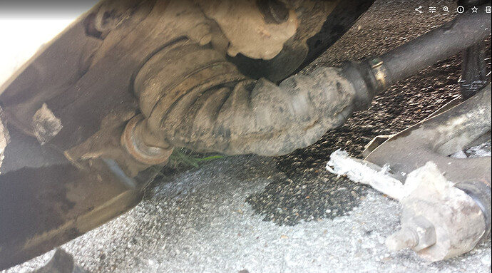

Ball joint failure at speed… No one was hurt per the customer…
Yes, it ground the end of the lower control arm off, you can see the ball still in the knuckle/spindle…

Most likely not, as the inner cv axle joint will separate when the ball joint fails, so no more drive wheels, unless it has a really good limited slip differential of some kind.. But even at that, it would most likely slip due to the angle of the wheel/tire now dragging on the ground, and possibly parts of the vehicle now dragging on the ground also…
Yeah you wouldnt drive far like that. Not to be â– â– â– â– â– â–  but if the ball was still in the socket, what broke?
On the Avalanche in the pic I posted??
The socket is missing, it was in the lower control arm that was ground off, what you are seeing is the top of the ball with the stud still mounted in the spindle/knuckle… The stud points down, not up in that set up…
Looks like the complete ball joint remains in the steering knuckle, the ball joint housing pulled out of the control arm or the control arm broke. Isn’t the suspension damage the result of the collision?
