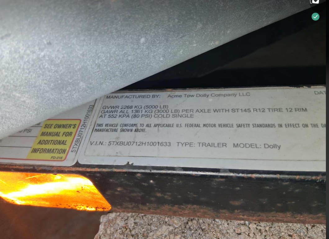

I have a new to me 2017 tow dolly with ST145/R12 10 ply load range E, yes a 12" 10 ply tire.. lol
80 max psi
Load Capacity 1520 Pounds
Manual says to run 75psi
Sticker says 80psi
I checked @CapriRacer ST psi info link and it starts at 13" tires…
I will be towing the 2009 Cobalt (ugg) about 60 miles back home, just triple checking to run 75-80psi..

What does sidewall say is max load and max psi? Maybe I missed that.
I’d run what the manual says - although 75 psi sounds a bit high. Keep an eye on it when you first start out. If it bounces too much, you might want to lower the pressure.
Travel trailers have a very high tire pressure. I’ve owned 2 pop-up trailers and each one had a recommended tire pressure of 80psi. Both used 12" tires.
I found this on their website…
Tires require 80 psi loaded. Lower to 20 psi for unloaded transport.
