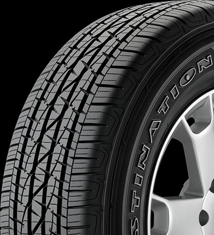

What about the Firestone Destination LE-2? It’s highly ranked in Tirerack.com owner surveys.
One of the owners wrote a positive review that said the tires “Rank as good as top rated Michelin LTX M/S which I have always purchased in past when needing new tires.”
And Tirerack.com has several other tires in the same size.

Yeah, 235’s should be fine, they are only 10mm (3/8’s inch) wider. Put me in the Firestone Destination LE2 camp. I have a set with 3000 miles now on my truck. This set was preceded by 2 sets of the earlier Destination LE’s with 45 to 65,000 miles on each set. It is a good tire. Quiet, long wearing, good on road traction wet and dry, decent off road traction if you don’t ask too much and good price.
Anyone know about snow and LE2?
From a tire rack review:
“I installed a set of the Destination LE2’s on my '08 Highlander last August. Overall performance has been exceptional and their traction was so good in the early snows we received in my region that I never bother to rotate them off in favor of the Blizzak set I have for the winter. I would buy these again in a heart beat.”
