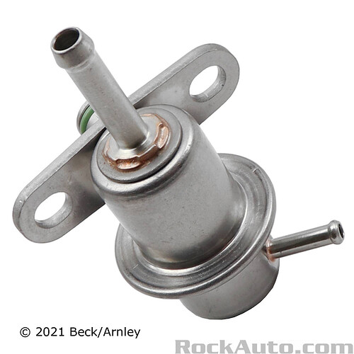

Locate the fuel pressure regulator.
Remove the vacuum hose from the regulator, and if gas leaks out at this connection the diaphragm in the regulator has ruptured and allowing excess fuel into the engine.
This would fit with a bad regulator. Not enough fuel pressure, not enough fuel into the engine so the computer holds the fuel injector open longer.

Definitely follow Tester’s triage steps for the regulator before considering the IAC.
Thanks Tester.
I just got back in from removing the idle control valve. I went back out and pulled the vacuum hose, no gas , dry.
