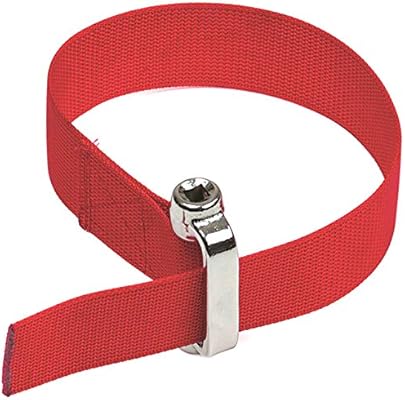

I think back to the peg board under a shelf of common filters where over the years every seemingly worthwhile filter wrench was hanging and recall that one similar to this
was usually the first one picked up and it usually got the job done. And while there have been some problems getting filters off I usually jumped straight to the hammer and punch. After driving a hole in the can near the base I was able to get the punch to connect with one of the holes in the base and get enough movement to twist it loose by hand.
