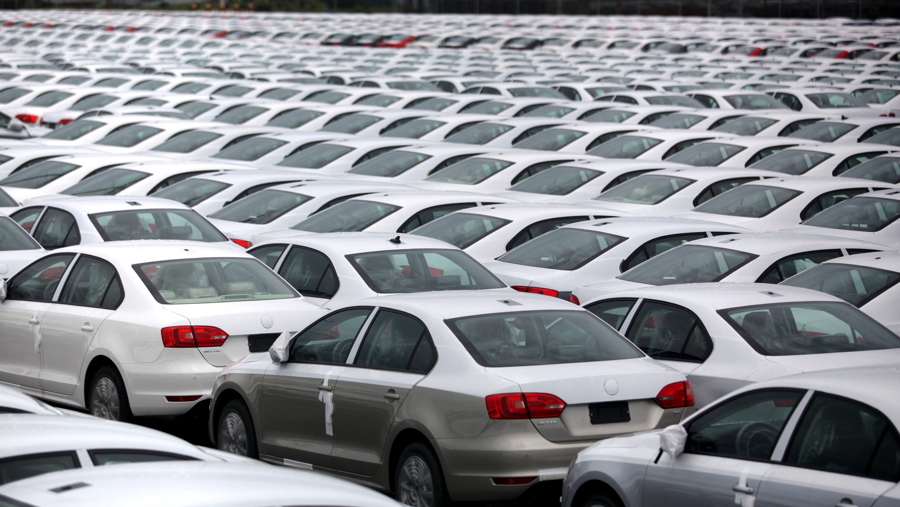

That is partly because they are built in Toluca. I drove by the plant when I was there 15 months ago. They had rows and rows of brand new Chargers and Challengers sitting outside, waiting to go on rail cars for the trip north. There is no duty to be paid on Mexican built vehicles. NEW USA built vehicles are expensive to take into the country.
Whoever heard of an Ibeza outside of Spain or Mexico?
The picture shows VWs built in Puebla. I was there over night, but did not see the plant.
But I digress.
The VW plant is just north of the cuota (tollway from Mexico City to Vera Cruz, as you drive west out of the city.
