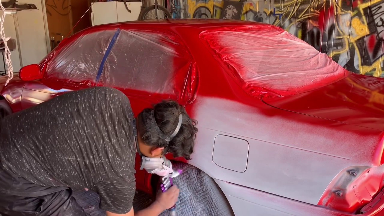

I was going to do the roof alone for $700 which means 2 stage painting - base first, 2 coats of clear last. I was going to take care of the rest myself - this involves bumper - I didn’t have good luck with the bumper before. Folks at home wanted the whole car for $1200 - so went with it. As long as I systematically wax the car, the paint will last. There is still 2yr warranty. Attaching some photos:
Update, they stopped using Enamel paint since a year ago.
Well it looks nice. Take care of it and good luck.

It sounds like you got a lower-end paint job and it might not “last” very long, imo

Metallic is clearly visible for the eyes.
