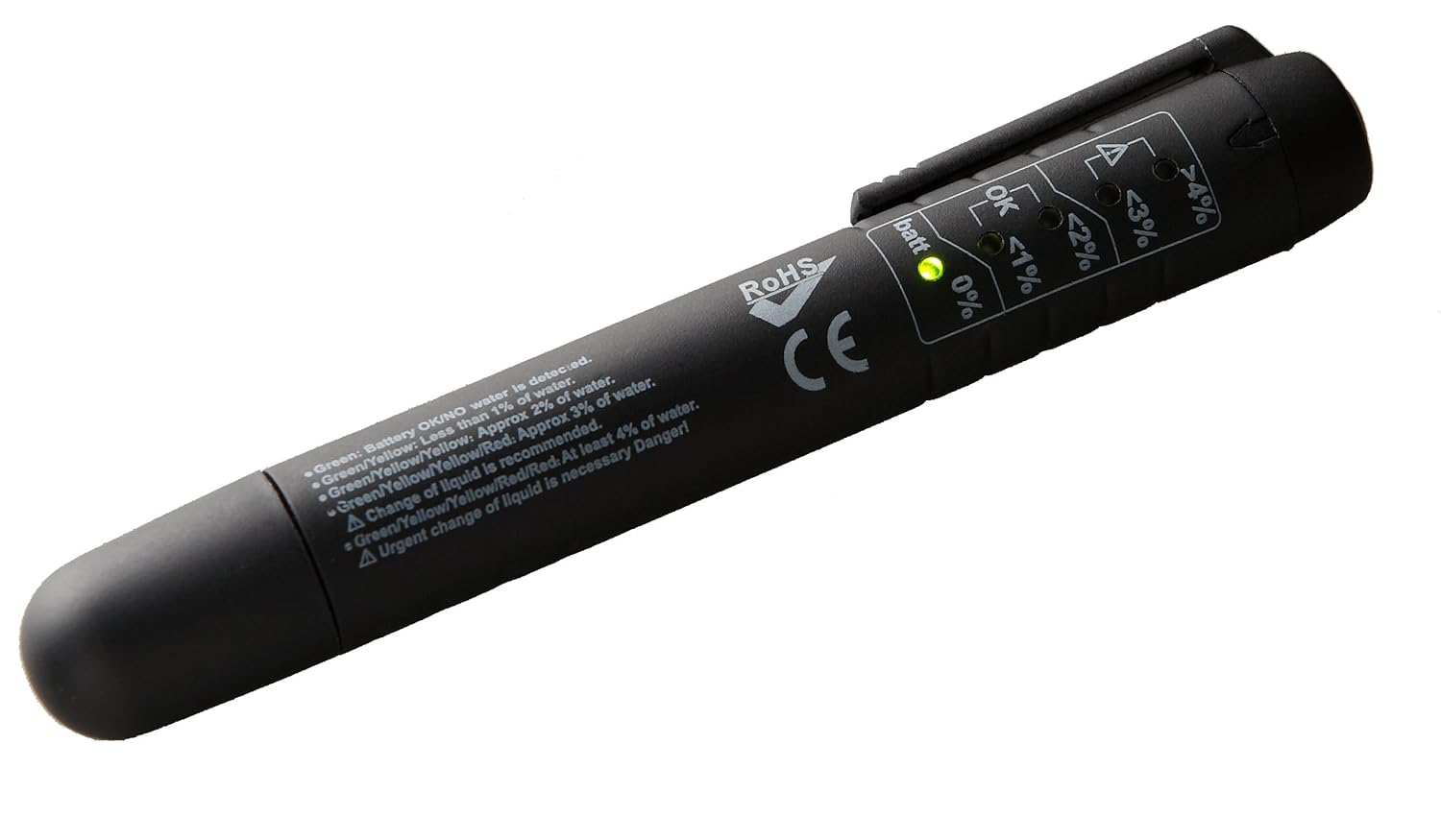

I just ordered one of these for Dot 4 fluid
For $22, this is a cheap tester every inspection station or mechanic should have. They are available for Dot 3, too.

@insightful; Thanks for posting that. Maybe that is why mine gets dark fast. Not that the color is the best indicator, but still bothers me. The tool posted by Mustangman is neat too, not sure if I can skip changing the dark fluid after 2 years even if it check okay. Seems a bit like sending your oil to blackstone for testing.
