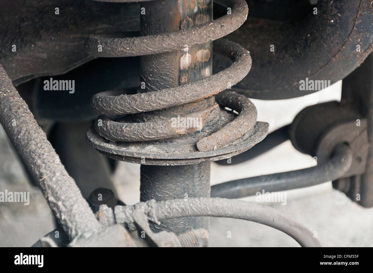

Look closely at that strut spring to see if the coil has broken.

I agree with Tester… broken spring.

Must also apologize for a bit of stupidity on my part in one post above. I was completely mistaken that I had to jack the car up more on one side. I eyeballed my jackstands wrong, and I incorrectly thought they were different heights. However, I got a good education from your replies, and I did check out the strut springs in a couple different ways, as you all suggested. Great education in possible causes of “clangs”. Deep thanks to all.
