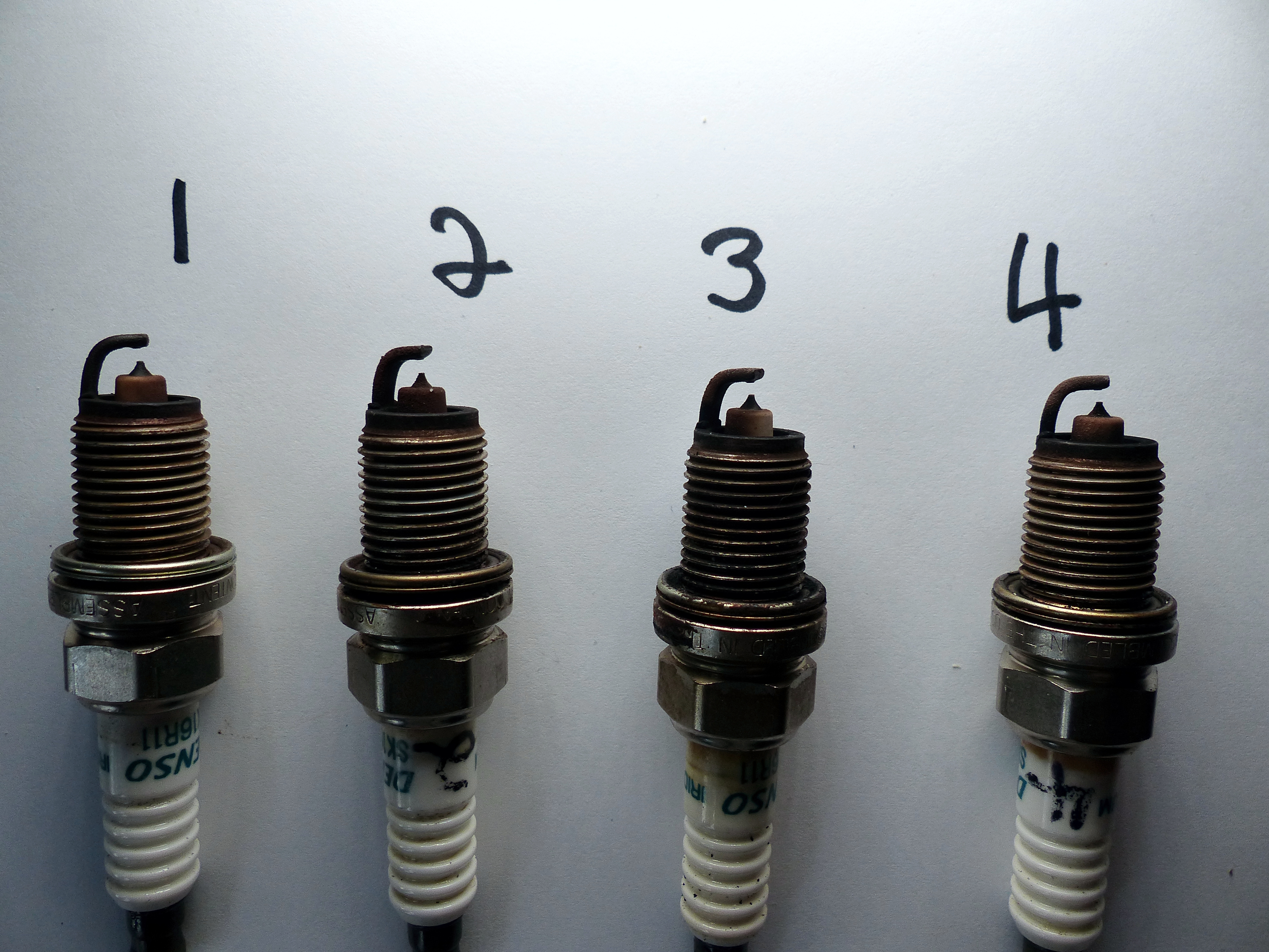

Plug gap specification is .043
Old plugs were at .048, .049, .052, and .053.
I do not know if the larger gaps on the old plugs would have been an issue. But since I was changing the coils I changed the plugs too, since they had 5 years and 90,000 miles on them.
Seems there was considerably more than a 10% increase in the spark plug gap; that could indeed have damaged or stressed the coils. The next question is why? You’ve a seen the claim here (above, post 16) that iridium plug gaps do not change at all, or only a minor amount in 120K miles. A couple of seemingly implausible reasons for the large increase in gap over just 90K miles:
  • Maybe the plug gap didn’t change, but was incorrect when they were installed originally.
  • Maybe the original plugs were counterfeit , not iridium
Did you check the gap on the 5 year old plugs before installing them… I have seen that much difference, which is not a lot, on new “pre gapped” plugs out of the box… I don’t care what anyone says, I always check and set plugs no matter what with single ground electrodes…

Yes, I check the gaps even though they are pre gapped` Below is a photo of the plugs. Number 2 was the plug that had the faulty coil.
Full size image if you want to really zoom in is here.
