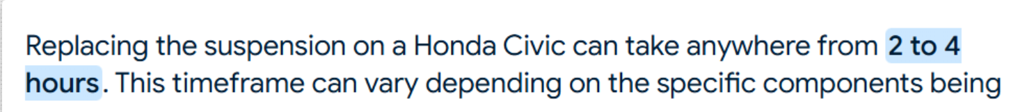

Yep, Its-me was right. Job only takes 2 hours to complete…. “9 Hours” is just a bid since he isn’t profiting on parts. Guess both shops in my city are dishonest now. Wow.. bad deal.
Thanks man for all your advice. Something felt very off and with your help I found out im being overcharged 4x the labor service.

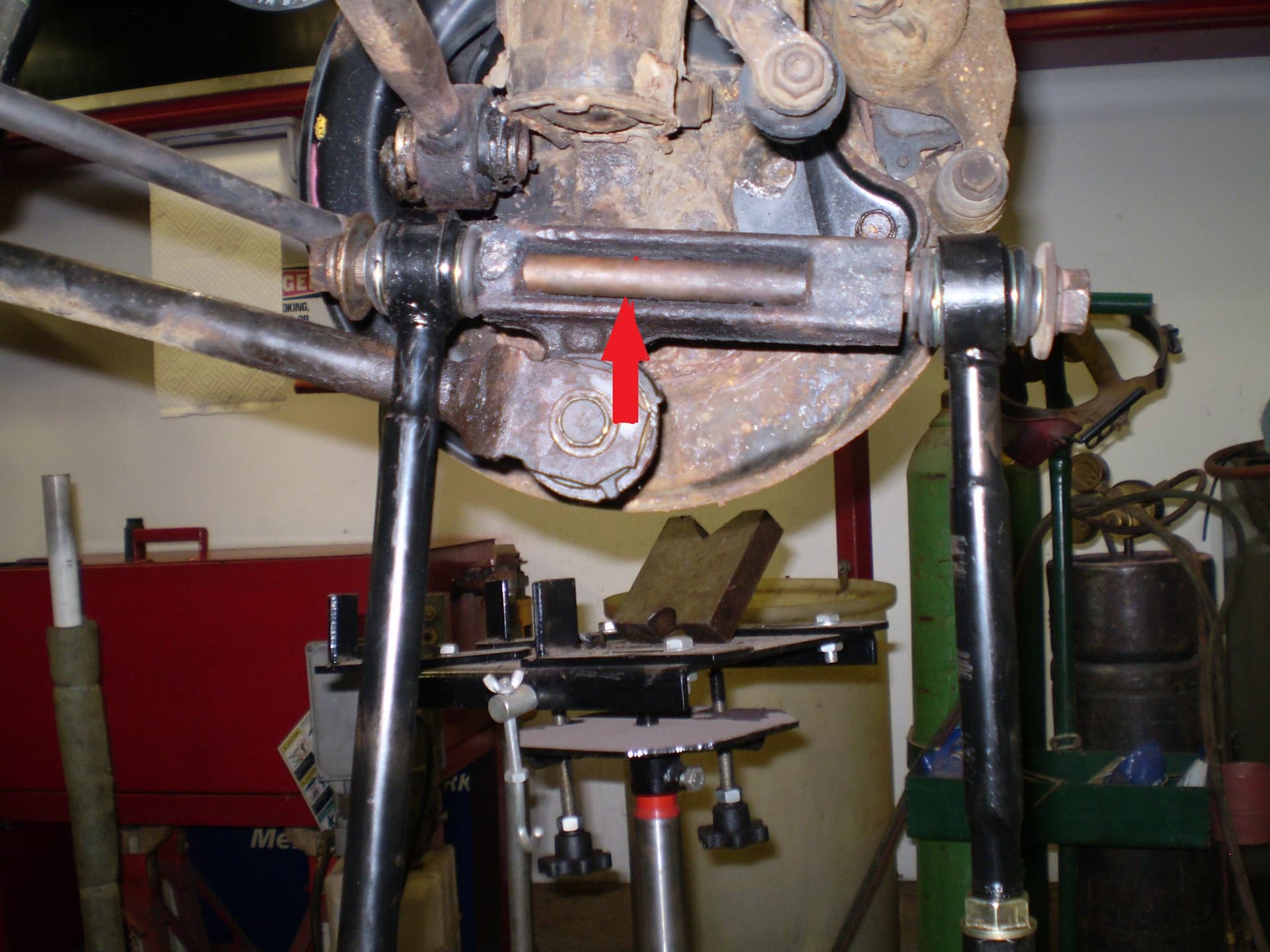

See that long bolt?
It took over 12 hours to remove the one bolt so the rear radius arms could be replaced on a Camry.
And I have all the tools.
When it comes to replacing suspension/steering components on a vehicle as old as yours you can’t go by the book.

Yeah, I can SMELL the AI sheen all over that “2-4 hour” suspension estimate. :grinning_face:
Thank you Tester, Fodaddy, Nevada for telling me the book time is accurate. Google made it seem like i was being scammed, and shop A was only charging for 7 hours, something felt off but Fodaddy explained how the pricing works.
lol thats why i posted instead of trusting google/AI crap now xD
