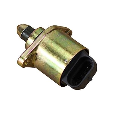

Have you tried cleaning the idle air control valve?
thanks jesmed. my set up is slightly different than the one shown (pcv as opposed to ccv system), but I will clean that valve today and see what happens.

I seem to have a different set up @jesmed1, I have multi port injection, not throttle body injection as is common. I have an idle speed stepper motor and a throttle position sensor but no idle air control valve that I can see.

I don t seem to have an IAC, cleaning that seems simple enough if I did, I have an idle stepper motor, unless that’s the same as IAC. it does not seem to be the same. I think the IAC is on throttle body injection not Multi port injection, but I may be wrong.

aha! the idle speed stepper motor does seem to be the same as IAC and it was loose and filthy! I turned the torx screws by hand
and the o ring is missing!
Yes, the stepper motor is the idle air control…hopefully that does the trick!
yep, I hope so. I cleaned it and am putting it back on to go find an o-ring now. I hope it starts :slight_smile:
