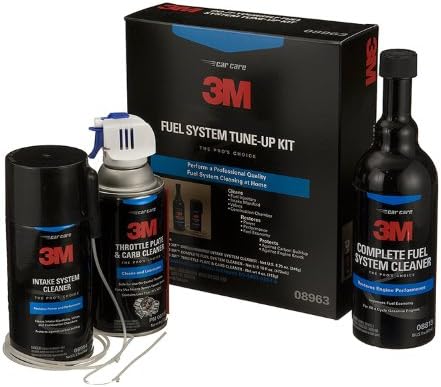

looking for info on 3m fuel injection kits. Are they worth the money and do they really work?

If I was having drivability problems, and if a bottle of Techron didn’t clear it up, I guess I might spring for the $30 or so for the 3M kit, worth that much to see if it fixed the problem.
@texases
What $30 kit?!
It seems to me $30 isn’t going to get you much
Here’s the 3M kit on Amazon:
Like I said, just a gamble that I could avoid a mechanic session…
