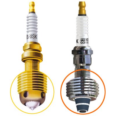

Mike, have you ever seen the tip of a racing plug?
http://www.ngk.de/fileadmin/Dokumente/EN/Kataloge/SparkPlug_GlowPlug_2013_2014_EAST.pdf see page 23.
http://www.autolite.com/products/racing-spark-plugs.aspx
They do use iridium tips on some, some are surface gaped and some just use a cut back anode. The cut back anode was popular, and the only option back in the day (60’s) unless you went to aviation type plugs which were multi anode or surface gap.
I used to cutback the anode on my spark plugs myself, but they would only last about a 1000 miles.
Here’s a few examples of high performance race plugs for ya…
