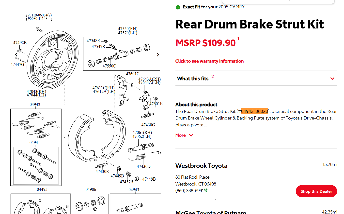

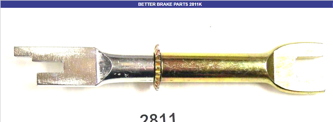

Only a few bucks online aftermarket. Like $10

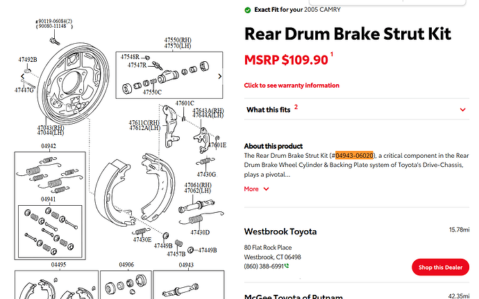

Toyota doesn’t sell just a single one, and you have to buy both by the looks of it. More than $100 lol.
