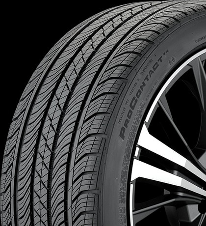

You need a Continental ProContact TX tire like the one in the link.
