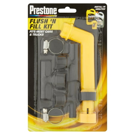

If not, see if there’s enough room to install a flush kit on a heater core hose.
A garden hose is connected to the flushing tee and the cooling system is flushed out.
If this won’t work, then fill the radiator with water and bring it to shop so the cooling system can be flushed and refilled with fresh coolant.

If you use the antiquated flushing tee you will have to drain the water from the engine before you can add the coolant.
