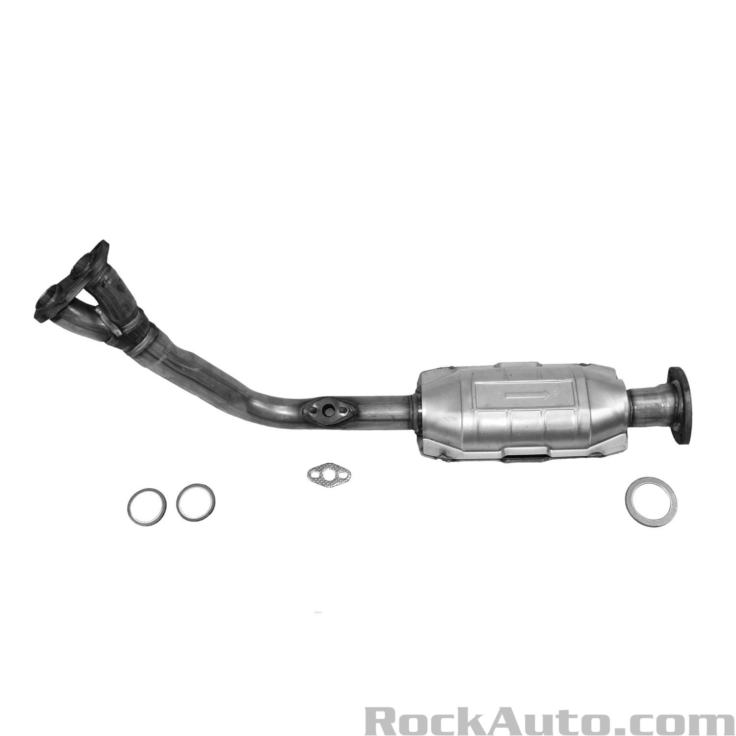

You need to find a name brand bolt on direct fit catalytic converter that looks like this…
I always used MagnaFlow or Walker direct fit cats…
It’s pretty outrageous, but I’m stuck here for a while. I’ve heard a lot of horror stories about aftermarket cats not lasting but never understood why.
I may try this again, previously when I tried to order these there weren’t any available for my model 4Runner, so I may try again. Unfortunately when they stole my converter they cut the downstream flange off so I will have to buy a new muffler and exhaust pipe too to bolt it on to.
